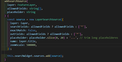

Hello,
I am trying to use the search widget with Arabic characters but it returns no result.
I found some articles on editing the where clause and adding the letter N before the search term
How can I add it to the code?

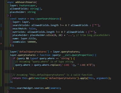

MohammedZaki
Thanks a lot, @JoelBennett  that was very helpful. I changed the code a little bit to work with TypeScript. Appreciate your help.
Regarding the use of the letter N in SQL (as the feature layers are not hosted in my case, we are dealing here with registered enterprise geodatabase layers)
The letter "N" before the string in SQL stands for the National Language Character Set (NCHAR) prefix. In SQL, prefixing a string with "N" indicates that the string is in Unicode format. Unicode is a character encoding that supports a wide range of characters and symbols from various writing systems, including Arabic, Chinese, Japanese, Cyrillic, and many others.
When dealing with non-ASCII characters, such as Arabic letters, it is important to use Unicode encoding to ensure proper handling and representation of these characters in the database. Using the "N" prefix in the SQL query, as in this example, allows the database to interpret the string as Unicode, and thus, it can correctly match and query the Arabic words in the "governorate" field.

MohammedZaki
