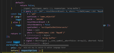

I tried to use the interceptor and set a breakpoint.
The interceptor is simply placing a '%' infront of the search term.
Suprisingly, right before doing the interceptors magic the request options already do contain a like with % before and after the search term. Unfortunately is still does not
Any ideas on what is still going wrong?
We are using 4.34
