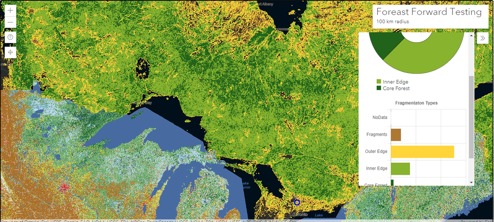

The desired used experience would be that they would upload a shapefile boundary of their choice and in turn this would generate multiple landcover charts for all the image services that have been added to the map ( Which is why we ensure that the image services would use the same formats). Something like this multiple charts image which uses the same sample for two different raster layersMultiple Charts imageMultiple Charts image
The charts would be the desired output. We do no need the clipped raster layers to be added to the map but if we have to its absolutly fine.

As mentioned previously there are more than one way to do this task depending on your needs.  If you have multiple layers but don't want to display them in the map and still create these types of charts, then using a client-side pixel filter is probably not the way to do this as your use-case and workflow are very, very different.  I would suggest you investigate the use of histograms as a possibility.  You can still pass in the 'clip' raster function as part of the renderingRule.  The counts you get back would represent the number of pixels in each class and you could build the charts based on those values.
