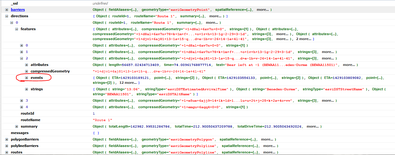

Using dojo/aspect i'm able to get the result returned by the service which contains the events in the directions.

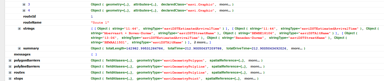

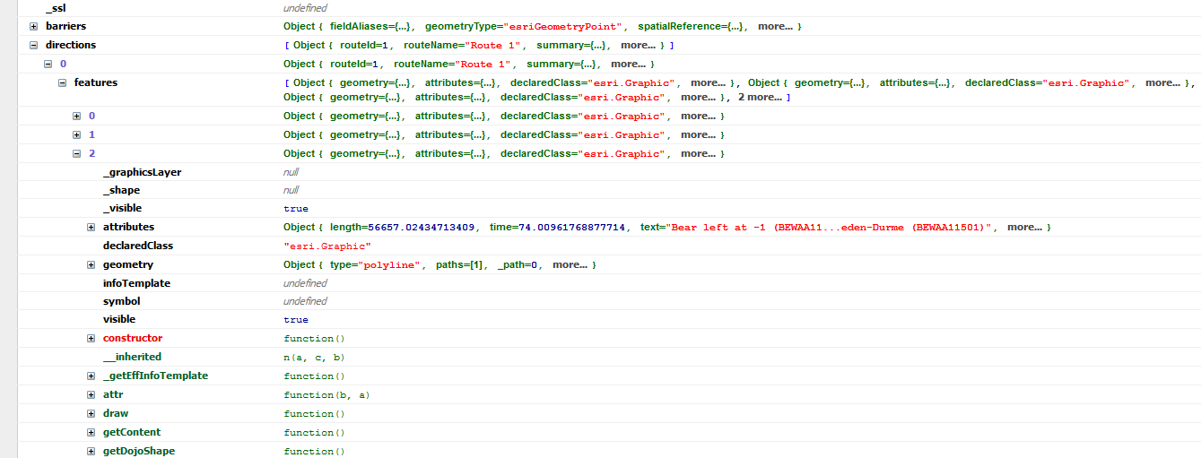

The result returned by the routetask on completion does not included these events.(see screenshots below)

Example json returned by service :
Example json returned by routetask :
