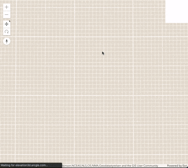

Hello,
I am attempting to render around ~500 graphics at once to a SceneView using:
const view = new SceneView({...})
const graphics = [...arrayOfGraphics]
view.set('graphics', graphics)
But whenever I do this, the entire browser hangs for a bit as you can see in the GIF below. I have an animated square in the top right corner to show that the stutter is affecting elements outside of the map container div.
Is there a better way for me to render a large amount of graphics to a SceneView at once? If there is no way to speed this up, is there at least a way to make it just halt the map and not halt the entire page?
Thank you

        { latitude: 40.574203, longitude: -105.034622, altitude: 19139 },
        { latitude: 40.589756, longitude: -105.04213, altitude: 19066 },
        { latitude: 40.5995501, longitude: -105.0423199, altitude: 19063.5 },
        { latitude: 40.603951, longitude: -105.041885, altitude: 19012 },
        { latitude: 40.6075194, longitude: -105.0415395, altitude: 19027.8 },
        { latitude: 40.60704, longitude: -105.041565, altitude: 18996 },
        { latitude: 40.610153, longitude: -105.041306, altitude: 18986 },
        { latitude: 40.613277, longitude: -105.0411, altitude: 18972 },
        { latitude: 40.626862, longitude: -105.042076, altitude: 18914 },
        { latitude: 40.630589, longitude: -105.043106, altitude: 18894 },
        { latitude: 40.6346523, longitude: -105.0444858, altitude: 18902.7 },
        { latitude: 40.634327, longitude: -105.04435, altitude: 18874 },
        { latitude: 40.649338, longitude: -105.049538, altitude: 18778 },
        { latitude: 40.680386, longitude: -105.058273, altitude: 18675 },
        { latitude: 40.685192, longitude: -105.059662, altitude: 18655 },
        { latitude: 40.690136, longitude: -105.061066, altitude: 18647 },
        { latitude: 40.695107, longitude: -105.062508, altitude: 18640 },
        { latitude: 40.7146, longitude: -105.066925, altitude: 18575 },
        { latitude: 40.719265, longitude: -105.067474, altitude: 18559 },
        { latitude: 40.723976, longitude: -105.068016, altitude: 18523 },
        { latitude: 40.736103, longitude: -105.073372, altitude: 17813 },
        { latitude: 40.738789, longitude: -105.072586, altitude: 17490 },
        { latitude: 40.744152, longitude: -105.073166, altitude: 17165 },
        { latitude: 40.747898, longitude: -105.070702, altitude: 16799 },
        { latitude: 40.74987, longitude: -105.068321, altitude: 16357 },
        { latitude: 40.755531, longitude: -105.060982, altitude: 15407 },
        { latitude: 40.759731, longitude: -105.055428, altitude: 14946 },
        { latitude: 40.777832, longitude: -105.036011, altitude: 13317 },
        { latitude: 40.781601, longitude: -105.027107, altitude: 12943 },
        { latitude: 40.785397, longitude: -105.017151, altitude: 12571 },
        { latitude: 40.789516, longitude: -105.007607, altitude: 12197 },
        { latitude: 40.793633, longitude: -105.000565, altitude: 11829 },
        { latitude: 40.797295, longitude: -104.995094, altitude: 11465 },
        { latitude: 40.800182, longitude: -104.989929, altitude: 11113 },
        { latitude: 40.802456, longitude: -104.984604, altitude: 10756 },
        { latitude: 40.805653, longitude: -104.979118, altitude: 10399 },
        { latitude: 40.80994, longitude: -104.974251, altitude: 10050 },
        { latitude: 40.82032, longitude: -104.963829, altitude: 9362 },
        { latitude: 40.825367, longitude: -104.960938, altitude: 9026 },
        { latitude: 40.830486, longitude: -104.958206, altitude: 8686 },
        { latitude: 40.8349, longitude: -104.955833, altitude: 8360 },
        { latitude: 40.839096, longitude: -104.953575, altitude: 8061 },
        { latitude: 40.844311, longitude: -104.950172, altitude: 7766 },
        { latitude: 40.849205, longitude: -104.946877, altitude: 7487 },
        { latitude: 40.853397, longitude: -104.943626, altitude: 7200 },
        { latitude: 40.857365, longitude: -104.941017, altitude: 6913 },
        { latitude: 40.861279, longitude: -104.938622, altitude: 6589 },
        { latitude: 40.864994, longitude: -104.936195, altitude: 6278 },
        { latitude: 40.868446, longitude: -104.934349, altitude: 5991 },
        { latitude: 40.871861, longitude: -104.932014, altitude: 5717 },
        { latitude: 40.875134, longitude: -104.930138, altitude: 5468 },
        { latitude: 40.878098, longitude: -104.929001, altitude: 5212 },
        { latitude: 40.880951, longitude: -104.928192, altitude: 4960 },
        { latitude: 40.88319, longitude: -104.927895, altitude: 4710 },
        { latitude: 40.885307, longitude: -104.92765, altitude: 4458 },
        { latitude: 40.887836, longitude: -104.927071, altitude: 4218 },
        { latitude: 40.890076, longitude: -104.926125, altitude: 3977 },
        { latitude: 40.891754, longitude: -104.925194, altitude: 3741 },
        { latitude: 40.892826, longitude: -104.924026, altitude: 3501 },
        { latitude: 40.892277, longitude: -104.919189, altitude: 2568 },
        { latitude: 40.891285, longitude: -104.919434, altitude: 2321 },
        { latitude: 40.890442, longitude: -104.919769, altitude: 2072 },
        { latitude: 40.890438, longitude: -104.919518, altitude: 1825 }
    </script>
    <style>
      html,
      body,
      #viewDiv {
        padding: 0;
        margin: 0;
        height: 100%;
        width: 100%;
      #overlayDiv {
        position: absolute;
        top: 0;
        bottom: 0;
        right: 0;
        left: 0;
        pointer-events: none;
      .box {
        animation-name: alertDanger;
        animation-duration: 1s;
        animation-iteration-count: infinite;
        animation-direction: alternate;
        background-color: white;
        position: absolute;
        right: 0;
        top: 0;
        width: 100px;
        height: 100px;
      @keyframes alertDanger {
        0% {
          background: red;
        50% {
          background: white;
    </style>
  </head>
  <body>
    <div id="viewDiv"></div>
    <div id="overlayDiv"><div class="box"></div></div>
  </body>
</html>
RalucaNicola1
hey, an improvement would be to define the symbols using the class and not by autocasting. When using a class it will reuse the symbol instance for each graphic and when you use autocasting it will create a new symbol and that might lead to poor performance. I updated your app here: https://codepen.io/ralucanicola/pen/wveGxQm?editors=1000 can you try it out and let us know how it performs for you?
