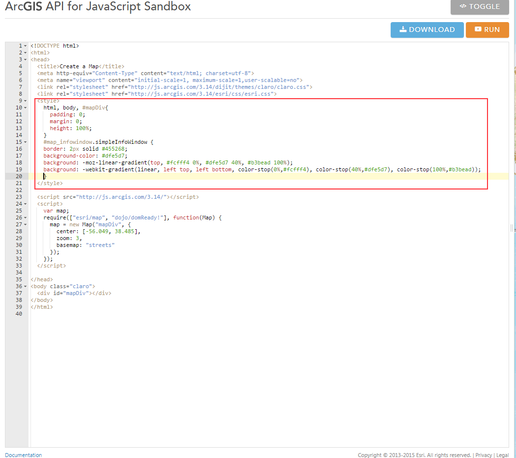

TimWitt2
MVP Alum
Ben,
you put this in between your style section (the red box in the attachment).
Tim
BenScott1
Deactivated User
Yes but that doesn't work.  If I take the example for using the infowindowlite (from Info Window Lite | ArcGIS API for JavaScript ) and paste it into the sandbox it works with the default style.  If I then add the extra css style as per below the style of the info window doesn't change from the default, which leads me to wonder if there is some way you have to reference the style when constructing the infowindowlite in the javascript code.

SteveCole
Honored Contributor
Ben, remove the #map_infowindow part from that CSS snippit. It should just be this:
.simpleInfoWindow {
border: 2px solid #455268;
background-color: #dfe5d7;
background: -moz-linear-gradient(top, #fcfff4 0%, #dfe5d7 40%, #b3bead 100%);
background: -webkit-gradient(linear, left top, left bottom, color-stop(0%,#fcfff4), color-stop(40%,#dfe5d7), color-stop(100%,#b3bead));
BenScott1
Deactivated User
Thanks Steve that did the trick.
