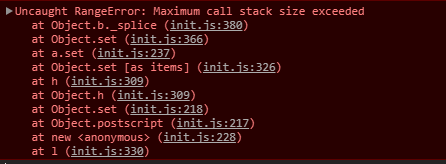

I would like some assistance regarding to the the 4.4 API that you guys have. My current issue right now is that I am receiving an error from the API's code when I try to set an array of graphics to an already initialized graphics layer.
More specifically, this is the error I am getting:
Just for clarification the length of the array that I am setting to the graphics layer is about 88000, however, I am expecting to test against data larger than that. I can't do that though if I am running into this error when testing against this much data.
So, I was wondering if someone had any resolution to this issue? Any help would be appreciated.

I think u are doing something wrong on handling the array of graphics that made the computer's memory hits the call stack limit so the browser hardcoded stack size or memory exhaustion.

That does make sense somewhat, but this error happens after I
1. Process geometries from an arcgis rest api call
2. Use those returned geometries to make an array of graphics
3. And then set that array of graphics to the graphics layer.
Also, I am not getting this error when the array length is not so huge.

Let me see if i understood. U are getting a data response that contains features from ur rest service?. In that case, why u are making a new array to pass it to the graphicslayer?
and also, which one is the purpose to use a graphicslayer?
If u wanna show data, make a ur desired query with something to filter the results (like definitionExpression or so).
Im not too familiar with the new api 4.x, but i have done a lot of complex queries on rest services with a lot of data, so to me its kinda weird that u have the "stack" problem with a variable.
