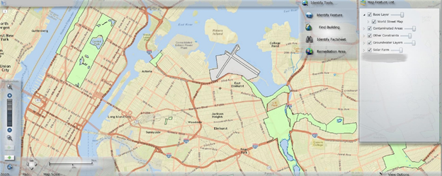

I have been asked to re-write a ArcGIS Silverlight application in JavaScript.  Below is a picture of what the application looks like in Silverlight.  Is this even possible ?  I've been trying to create the toolbar across the top, with the drop-down menus AND the table of contents that can turn on/off layers.  I've seen a lot of the templates on the ArcGIS Developer's website, but none seem to do anything similar to what I'm trying to accomplish.  Has anyone done something similar ?  Thanks.
