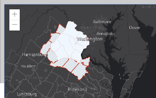

I am trying to query and return data from a spatial relationship.
I have a county layer with many counties
I have another Layer that has larger polygons that are made up of multiple counties.
I want to use the larger polygon to select the smaller polygons that would be inside the geometry of the larger polygon.
I have tried all the possible spatial relationships
Possible Values: "intersects" | "contains" | "crosses" | "disjoint" | "envelope-intersects" | "index-intersects" | "overlaps" | "touches" | "within" | "relation"
I think my issue is that the boundaries of the two Feature Layers coincide.  Is there any other way to query these?  Can I search by centroid of the polygon layer (create a centroid on the fly?)
        function queryCountiesthatIntersect() {
            var query = countyLayer.createQuery();
            query.geometry = resultsLayer.graphics.items[0].geometry;
            query.spatialRelationship = "index-intersects";
            query.outFields = "*";
            query.returnGeometry = true;
            return countyLayer.queryFeatures(query);

Jay,
   There is redundancy in your code.
        function displayResults2(results) {
            var testPoly = resultsLayer2.graphics.items[0].geometry;
            var finalFeats = [];
            results.features.map(function (graphic) {
                if (testPoly.contains(graphic.geometry.centroid)) {
                    var cGra = graphic.clone();
                    cGra.symbol = {
                      type: "simple-fill",
                      style: "solid",
                      color: [240, 248, 255, 0.9],
                      size: "10px", // pixels
                      outline: {
                        // autocasts as new SimpleLineSymbol()
                        color: [191, 42, 18, 0.9],
                        width: 1 // points
                    finalFeats.push(cGra);
                    resultsLayer3.addMany(finalFeats);

   I would try overlaps or contains.
jaykapalczynski
Honored Contributor
Should Return 11
Returns 3:  Contains only gives me the ones that are completely contained within the Large Polygon....it does not give me the ones that are touching the boundary of the Large Polygon....those lines coincide and are not selected with Contains.
Returns 19:  If I use Overlaps I get this....I get the ones that lie outside selected because the lines coincide.

Can I grab the centroid for Query?
Can I somehow tell the query to look at the centroids of each little county and use those centroids to find the ones that are "contained"????

Jay,
the best I know of is that you can get the polygon centroid like this
var countyCentroid = feature.geometry.cetroid;
So you would do your query like this:
function queryCountiesthatIntersect_step1() {
  query.spatialRelationship = "intersects";
then find if the resulting counties centroid is inside the polygon.
queryCountiesthatIntersect_step1.then(function(results){
  var testPoly = resultsLayer.graphics.items[0].geometry‍‍;
    if(testPoly.contains(graphic.geometry.centroid)){
      //Now you know if the centroid of the county is in your polygon
      // and you can add that graphic to the map or whatever...
jaykapalczynski
Honored Contributor
Having a hard time following this..
I have:
CountyLayer      var countyLayerWebMercator = new FeatureLayer({
                           this is the full county layer with hundreds of polygons
resultsLayer2    this is a graphic layer that houses the large polygon for the query.
                          this is the poly that I want to identify all the counties from the County Layer above
resultsLayer3     this is the graphics layer where I want to write all the counties that are within the resultsLayer2
                           all the polygons that have their centroid in resultsLayer2
Am I missing something?
// SNIP CODE ABOVE BUT HERE IS TEH CALL
            queryCountiesthatIntersect().then(displayResults2).else(function (err) {
                console.log(err);
            var query = countyLayerWebMercator.createQuery();
            query.geometry = resultsLayer2.graphics.items[0].geometry;
            return countyLayerWebMercator.queryFeatures(query);
            queryCountiesthatIntersect.then(function (results) {
                        // alert(testPoly.length);
                        var features3 = graphic.features.map(function (graphic) {
                            graphic.symbol = {
                                style: "solid",
                                outline: {
                                    width: 1 // points
                            return graphic;
                        var numCounties = features3.length;
                        alert(numCounties);
                        resultsLayer3.addMany(features3);

Jay,
   Unless I am misreading the code you ported you have an infinite loop going on.
queryCountiesthatIntersect().then(displayResults2)....
then in displayResults2 you have
Which is a function calling itself each time it finishes...

this is what I am trying to do now....just saw that loop
Although this still returns the features that are outside the area of interest....does not seem to be using this
Think it might be this.  Where I am calling the "results" again
var features3 = results.features.map(function (graphic) {
                //queryCountiesthatIntersect.then(function (results) {
                        graphic.symbol = {
                            style: "solid",
                            outline: {
                                width: 1 // points
                        return graphic;
                    alert(numCounties);

Jay,
                    cGra.symbol = {
                      style: "solid",
                      outline: {
                        width: 1 // points
