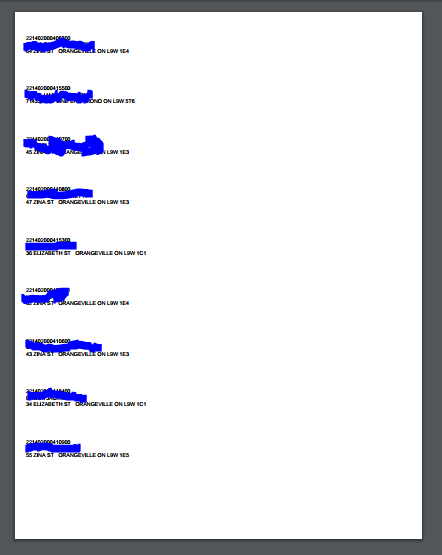

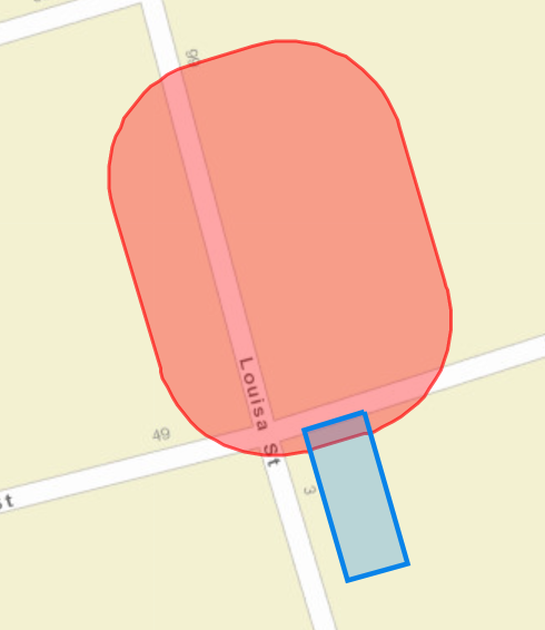

1) after selecting a parcel and choosing a buffer then executing the geoprocess... a buffer is drawn on the map, but only one property appears highlighted on the map (appears to just be the first returned), however the mailing labels and/or csv are complete with all the expected results of the buffer... its just not drawing them all on the map?!
Map Result
PDF Produced

What configuration do have for "parcelInformation.LowParcelIdentification" in config.js? If my understanding is correct, there will be only one graphic added to the map for each LowParcelIdentification id, whereas the result will be for all the features returned from the query. Does your data has the same value for that field?

I had originally quoted out low parcel, because it is in the Local Gov model but not the Canadian Local Gov (CMDM) that I'm using... I used the same attribute for Low Parcel and it seems to now draw all the parcels when buffering.
config.js ORIGINAL
//Fields information for parcels
ParcelInformation: {
//LowParcelIdentification: "LOWPARCELID",
ParcelIdentification: "ParcelID",
AliasParcelField: "Parcel Identification Number",
SiteAddress: "FullAddress"
config.js UPDATED
LowParcelIdentification: "ParcelID",
