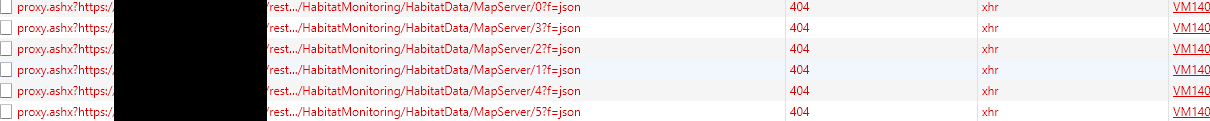

Alright. I have all the services in the config file. Now, no login prompts, however no data on the map either. I am getting a lot of "resource not found" in the console.
Network tab snippet:
When I go look in the header and response for details, this is in the response:
<span><H1>Server Error in '/' Application.<hr width=100% size=1 color=silver></H1>
<h2> <i>The resource cannot be found.</i> </h2></span>
<font face="Arial, Helvetica, Geneva, SunSans-Regular, sans-serif ">
<b> Description: </b>HTTP 404. The resource you are looking for (or one of its dependencies) could have been removed, had its name changed, or is temporarily unavailable.  Please review the following URL and make sure that it is spelled correctly.
<br><br>
<b> Requested URL: </b>/proxy/proxy.ashx<br><br>
So it seems like it can't find the proxy URL which suggests that my JS code needs to be altered in some way, right? I changed my proxyUrl to be an absolute path but that has not changed anything.

Back to "resources not found" errors when trying to load the map services. No log in window.
GET https://www.mydomain.org/proxy/proxy.ashx?https://www.mydomain.org/myServer/rest/services/HabitatMon... 404 (Not Found)

  It appears that the proxy url is not defined correctly based on the error:
 https://www.mydomain.org/proxy/proxy.ashx? It seems to be missing the appName portion of the url.
