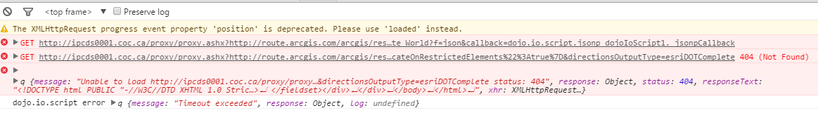

When I try to access the file on the dev server from my pc, I get the attached error message in the console (console.png).

I have tested the directions widget sample on both localhost and dev server. It works on localhost but not on dev server. So there's something that I've not done or forgotten with the dev server.

When I try the same on the dev server I get the following in the console (see attached picture)

Thanks Daniel. I changed the proxyurl to http://ipcds0001.coc.ca/proxy/proxy.ashx and I still get the same issues. I'm still wondering if there's some IIS setting that needs changing given that that is the location of the proxy.ashx and the browser keeps returning a 404 error??

Thanks for the reply Tracy. The result so far seems to be the same whether I use http://ipcds0001/directionswidget/index2.html or http://ipcds0001.coc.ca/directionswidget/index2.html
The result in the console is the same:
I'm thinking there's something on the dev server (ipcds0001) IIS that's preventing the browser getting at the proxy.ashx file.
