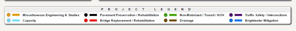

Thanks, Robert, but am I missing something? The user still has to click on an item in the TemplatePicker in order to select anything in the picker. For context, I'm trying to hide the editor in plain sight. Most users of the application will just view the content but I want a few people to have the ability to edit/add additional features. To accomplish this, I decided to take the legend  in my app (which is a series of JPEG images for the various feature types):
..and add a listener event so that people who "know" can click (or shift-click, etc) on the JPEG and that would select that feature type from the templatePicker and allow the user to sketch the feature on the map. I suppose you can dig waaaaay deep to get at the template by something like
widget.params.featureLayers.types.templates[0]
but, ugh. It's probably just easier to keep a series of variables with default values, add a generic feature using the editor, and auto-populate fields when committing the feature to the featureLayer.
