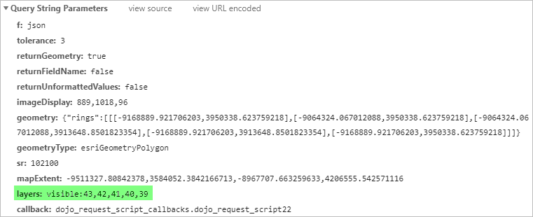

Here are a couple of screenshots that illustrate the problem.  Using the Chrome developer console I printed out the parameters being passed with the identify request:
Now, here's a screenshot of the results returned from the server:
Notice how every result has the same layerId and layerName value.  Only one of the results, the second one in the list, actually came from layer 43.  The rest came from layers 40 and 41.  Layer 40 is the only visible layer in the map. However, I have tried only sending the visible layerId, 40, in the request and the results are the same. It is basically returning features from all sublayers of the map service url I am supplying to IdentifyTask, regardless of what I pass in the layerIds array.
Perhaps it has something to do with passing the geometry from the polygon.  I'll keep banging my head on the desk until I figure it out.
