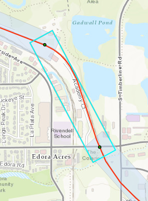

I am using the FeatureLayer.selectFeatures() function to select features on a user's click, but am having problems with it. Once a user clicks on a feature, it will flash the symbology that I've set as the selection symbol (red outline, transparent interior SimpleFillSymbol) and the show another symbology. I have inspected the return of FeatureLayer.getSelectedFeatures() with no success. Only the correctly symbolized graphic is present. I've attached a screenshot:

Upon further inspection, I found that the graphic was being added to the maps graphics layer. a simple call of
on(map.graphics, 'graphic-draw', lang.hitch(this, function(eventArg){
    map.graphics.clear();
cleared the graphics layer of the unwanted graphic.
