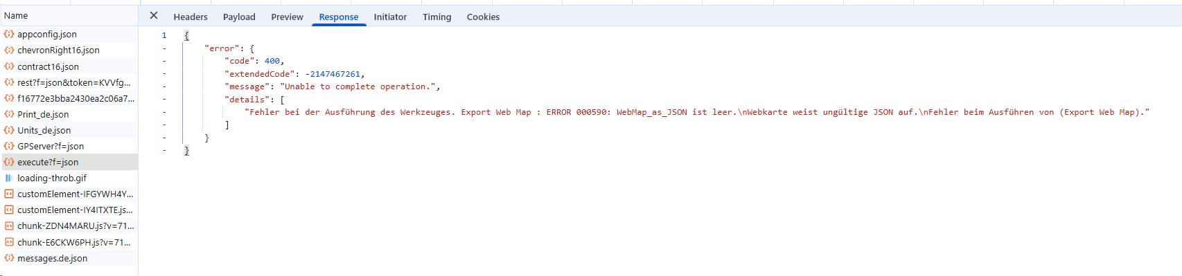

ERROR 000590: WebMap_as_JSON ist leer.\nWebkarte weist ungültige JSON auf.\nFehler beim Ausführen von (Export Web Map).
Saying the WebMap_as_JSON would be empty.
In the frontend it only shows this ugly error:
The Network Tab of DevTools give some more Info:

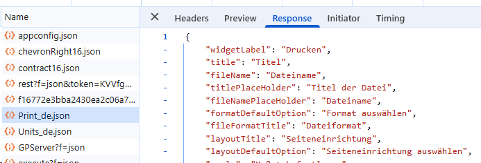

Dunno if this of interest but Print_de.json looks like:

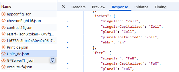

Units_de.json:

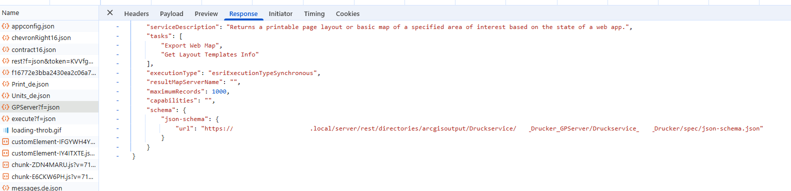

GPServer:

Turns out the "/execute" at the end of the print url is not "supported" any more in newer ArcGIS Version.
old URL (not working any more):
https://my.machine.local/server/.../GPServer/Export%20Web%20Map/execute
new URL (working Properly):
