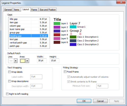

I think the problem here are the default print templates.
The legend is placed in the bottom of the page leaving very small room for the legend info. If a layer has too many symbols it will simply not be displayed in the legend. To check this, load just one or two layers in your app rendered with a simple renderer. You should see the layers info in the bottom left side of the page.
The solution is simple. Edit the default print templates and place the legend elment somewhere else leaving more space for the layer info. And also check that "Shrink contents to fit frame" option to make the layer info fit the legend element (you'll find it in the Fitting strategy section inside the legend properties,  here).

Thanks, I don't believe that this is the problem - at most my legend contains one layer with five classifications, and some of my maps are a single point layer rendered with a simple renderer. The "Shrink contents to fit frame" option is indeed selected, and the minimum font size is set to 4 pt. Any further thoughts?
