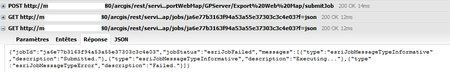

And if you print a map with a circle graphic, the print dijit just fail to execute and there is no way (I haven't found any) to capture the failed execution.

As you can see, this is my FireBug console...
Is there a way to capture that kind of error/failure from the dijit?

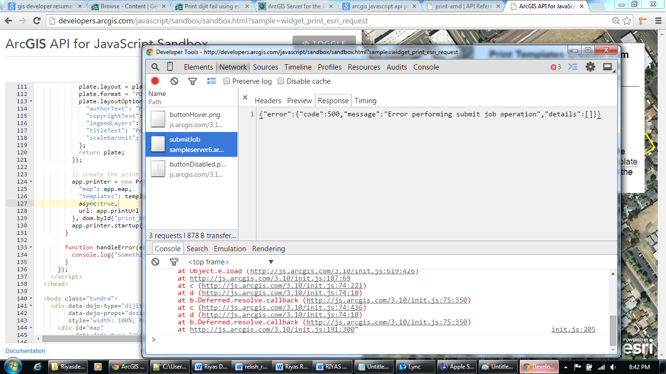

Hi Marc,
Try removing, async: true, I can simulate an error in ArcGIS API for JavaScript Sandbox  by just adding async true.
