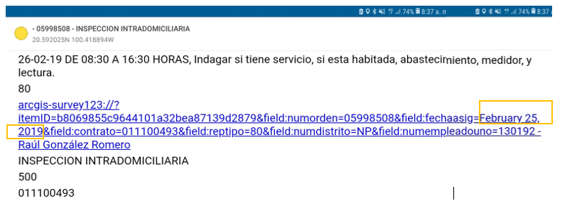

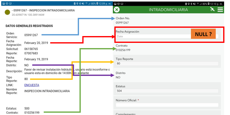

But we have a problem when we try to prepolate a particular date field into a related Survey123 the field isn´t display in the form.

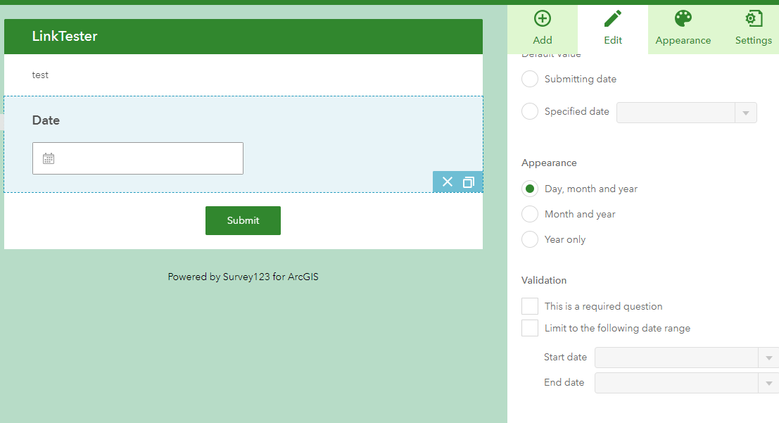

I have shared this simple survey with everyone.
I you try using this link in your popup, does it pass the date?
arcgis-survey123://?itemID=a05cbcce97e448d9b8bd1570eab697f6&field:DateField={created_date}
I think it should work.
Mark

In Collector tap and hold your link.
A panel will ask you what you want to do with the link, notice that the URL is shown on the Panel.
Does your URL have the correct date in it?
Mark
Comisión_Estatal_de_Aguasde_Qu
Hi Mark.
Yes, I think that my URL has the correct date.
Note: I use Collector Beta for Android.
 The date field isn´t display in the form
Ana.

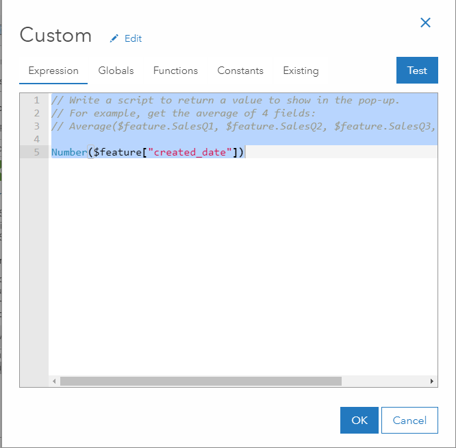

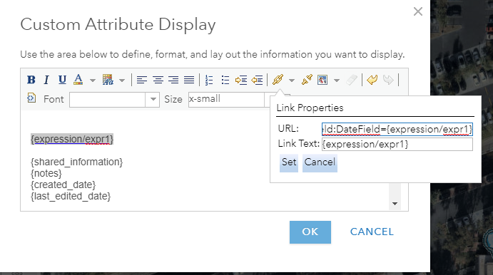

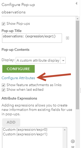

I think I have a solution,  instead of passing a "date string" which is prone to error, we can use Arcade expression to pass the date as an epoch time value.

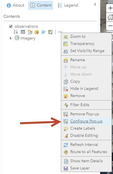

In your webmap.
Configure Popup

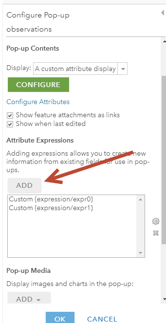

Add an Attribute Expression
Set your date field to a Number
for your data  Number($feature["FechaAsignacion"])
Configure the Hyperlink in the Popup to use the expression.
Notice in the Popup the value still is not correct. I used the Expression as Title and link text.
You also need to set the Formatting for the Arcade expression.
No Separator and No decimals
Now the Popup value for epoch time is correct.
This should pass correctly to Survey123
