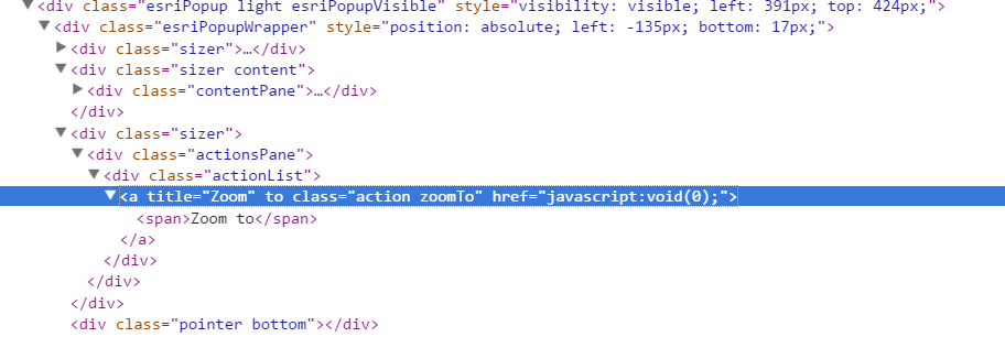

I am using a bootstrap map and pulling the styles from <link rel="stylesheet" href="https://community.esri.com//netdna.bootstrapcdn.com/bootstrap/3.1.1/css/bootstrap.min.css">
I am using a standard esri/dijit/Popup with an esri/InfoTemplate for the infoWindow of my featureLayer.  The 'zoom to' in the action pane is not displaying.  As I look into the elements of the infoWindow, I see that the style is coming from esriPopup.light as opposed to just .esriPopup.  Is this because of the bootstrap css I've referenced?
When I look the actionPane at the bottom of a typical infoWindow, the anchor looks like this:
<a class="action zoomTo" href="javascript:void(0);">Zoom to</a>
With the esriPopup.light, instead it looks like this
<a title="Zoom" to class="action zoomTo" href="javascript:void(0);"><span>Zoom to</span></a>
It says it's getting its style from esri.css, not the bootstrap.css.
I'm not familiar with all the nuances of CSS, but I've never seen 'to class'.  Is this a bug in the code?  This isn't anything I wrote, I simply defined my popup and infoTemplate like I normally would.   Looking at the elements, it would appear there is an attempt to have a Zoom To anchor, but in reality, there's just a narrow band where the actionPane sits.

DarrenWiens2
MVP Alum
Does it work if you delete the word "to"? I'm guessing they meant it to be <a title="Zoom to" class=...

ChrisSergent
Deactivated User
Just to expand on what Darren Wiens​ said;
You may want to report that. That line should probably be <a title="Zoom to" class="action zoomTo" href="javascript:void(0;">
If it is code that is being served up by Esri, you will not be able to change it and you need to ask Esri to correct the file, but if you are running it locally, you can search for-  to Class in your files and change the code.
