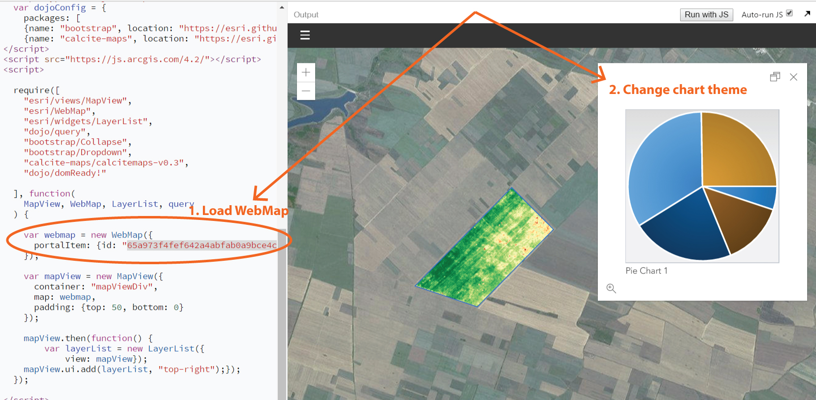

Is it possible to use the Popup Template when loading a WebMap ?
The Popup Template sample code is built in the context of loading a feature layer, but not an entire WebMap.
The sample code when loading a feature layer is
var featureLayer = new FeatureLayer({‍
  url: "..."
  popupTemplate: {
     mediaInfos: [{ ... }]
but how do you use the popupTemplate when loading a WebMap with feature & tile layers ?
var webmap = new WebMap({
 portalItem: {id: "..."}
My WebApp is available on JS BIN.
Michelle.
ThomasSolow
I think your best bet would be to edit the popup theme elsewhere, as Robert mentioned.  I don't know a lot about what goes into setting up these kinds of popups, but you're probably better off editing it in the application that was used to create the web map and define the pie chart in the first place.
Edit: this turns out to simpler than I thought.
You can change the chart theme like this: JS Bin - Collaborative JavaScript Debugging
You can totally remake the chart, which includes redefining which fields get charted like this: JS Bin - Collaborative JavaScript Debugging

What do you mean by "use the popup template?"  In other words, what's your goal here?
You can set the popup template per layer using the popupTemplate property, as in the sample you linked.  You can also set the popup template on a MapView or a SceneView using the popup property.  In the case of your app, it would be a MapView: MapView | API Reference | ArcGIS API for JavaScript 4.3
MichelleJean
Deactivated User
Hi Thomas,
My goal is to load a WebMap and then customize it's feature layer popup in order to set up a certain dojox charting theme.
The code above is available on JS BIN.
Can I do that using the popupTemplate?
popupTemplate: {
  mediaInfos: [{
      value:{
         theme: "..." }
If so, could you provide me a sample code? I can't seem to get this code working in my JS BIN.
Michelle.
ThomasSolow
