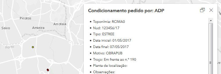

When I migrated from 3.20 to 4.30 version I had some troubles with the popupTemplate.
Sometimes the popup show coded values instead of field description and vice-versa.

This is the popup with coded values:
Anyone knows how to display always the field description? Thank you!
