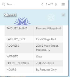

I'm in 4.9. How can I get the popup to display the title of each field using a Webmap? Right now, when you click the feature in the app the title displays as "Sheet1".

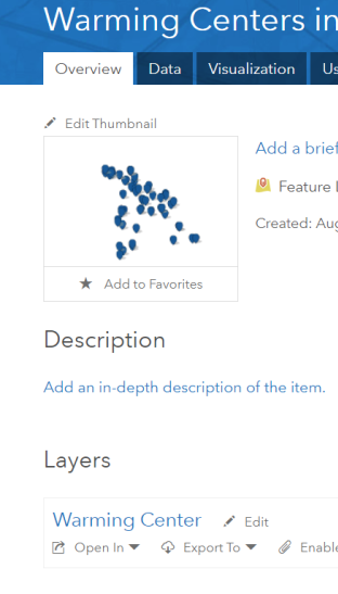

The feature layer in the Webmap is actually "Warming Center".

Jared,
   The WebMap already has the warming centers layer added so you are adding it again in your code and the Web Map layer has the title defined as Sheet1 for some reason. Here is what you need to do to fix this issue:
