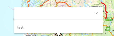

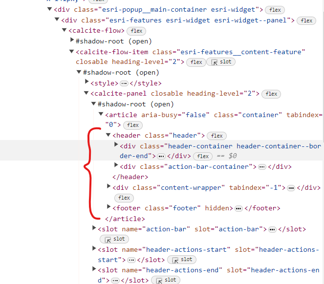

I would like to remove the header of the popup, but it is not possible to achieve this by overriding the CSS class directly. This limitation arises because the header is wrapped within a shadow root, as implemented by the calcite components. I am using arcgis javascript API version 4.28.9

I don't think there's a documented way to do this.  However, if the following executes prior to the creation of the Popup, it appears to achieve the desired results:
require(["esri/chunks/panel"], function(panel) {
    panel.Panel.prototype.renderHeaderNode = function() { return null; };
