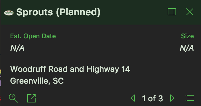

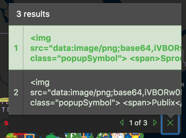

In 4.5 the Popup's featureMenu doesn't render svg or base64 encoded images, however in 4.4 both these rendered as expected.
I'm injecting some icons into the popup's title and it renders correctly in the title but not the featureMenu. Is there a way to get this working again or is this behavior now by design?
I've attached a couple images to show what I'm seeing. This behavior is exhibited in Chrome, IE, Edge, and Safari across both macOS and Windows.
Popup showing image in title
Image rendered correctly in the title
Img not rendered in featureMenu

Todd,
  This appears to be a bug in 4.5. You should contact tech support and report this or get your customer number added to the bug for escalation of this.
ToddAtkins
Thanks, I've submitted a case request via support.
ToddAtkins
If anybody is following this, Esri has recorded a bug for this issue: BUG-000108919PopupTemplate's FeatureMenu does not render base64 images in ArcGIS API for JavaScript 4.5”.
