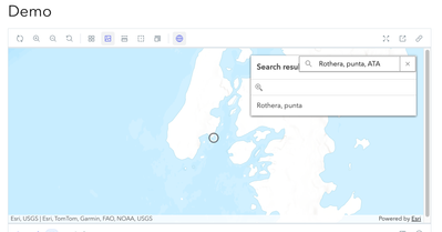

Hi @Noah-Sager , one thing I have noticed about the new popup behaviour is that the changes in the internal dom structure now means that the popup appears below slotted content. Unfortunately this means that docked results from searches now get covered up by any user interface components.
e.g.
Frustratingly there is no way now to actually handle the z-order conflict because the slotted content and rest of the view content sit in separate stacking contexts...
At the moment this has made docked search result content effectively unusable in our application with 4.34.

This sample shows the issue. Search for "Booker", see the the popup underneath the search, then click the feature and see it sitting above.
https://codepen.io/JDawe/pen/EaPLRVy

Hi @JonathanDawe_BAS, thanks for also posting your question here. What you are seeing with the Popup behavior is by-design (shout-out @LaurenBoyd). The Popup component should always be top-most in the UI. When using a Map component, the Popup widget will display below the component(s). When we talk about the Popup widget with a Map (not a Map component), then we see the same behavior where the Popup widget should always be top-most in the UI. Example:
https://developers.arcgis.com/javascript/latest/sample-code/sandbox/?sample=popup-docking-position
So mixing the Popup widget and Popup component is a little confusing, but the new Popup component behavior matches our design and our previous Popup widget behavior.
JonathanDawe_BAS
Thanks @Noah-Sager, I agree the pop up should always sit above the other ui elements. The issue I was pointing out was that at 4.34 this behaviour is now not true for the pop ups from a search component / any default pop ups. Previously In version 4.33 it did sit above the ui, meaning effectively there is a regression in behaviour when using the popup, as there is no way of making it use the new popup component to sit correctly in the z order.
I’m confused as to why it doesn’t just put the popup into the popup slot?
