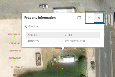

I have @ArcGIS/code Version 4.29.10 loaded into my React PWA app. The primary functionality is to display base layers, graphics, and/or feature layers, with some layers having popup templates enabled.
Recently, our customers have reported issues with the popup not closing when clicked. Upon investigation, I noticed that both the close and collapse buttons do not respond to mouse events, although other buttons on the popup work fine.
However, they work fine with taps on touch-enabled devices like iPads, as well as with keyboard events. This functionality was operating correctly at some point. How can I troubleshoot this issue?
Note: This appears to be an issue only on Chrome and Edge browsers. It works fine on Firefox.
