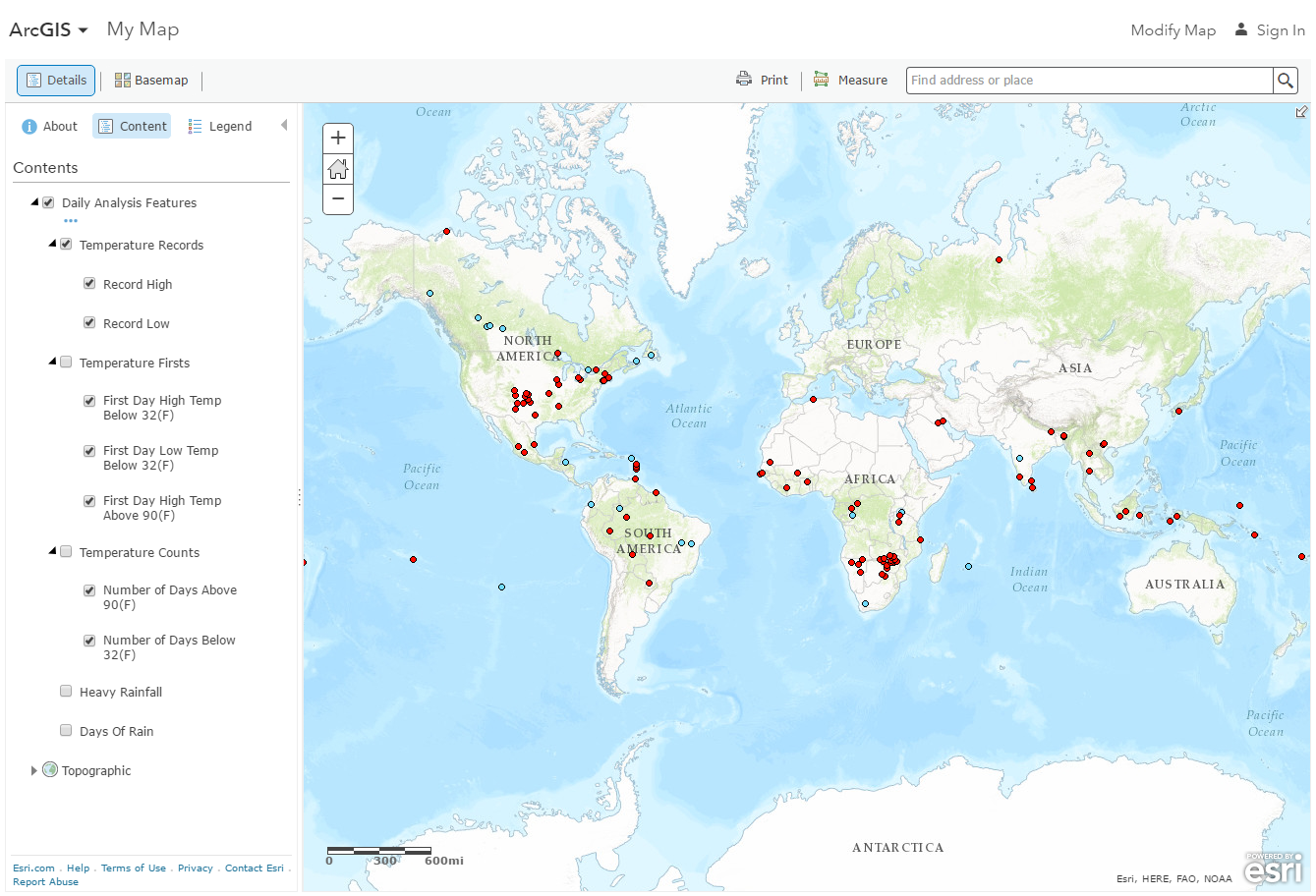

Lately the popup is getting stuck. I'll click a feature and get a result. If I click anywhere else on the map, even on a different layer, I'll get the same result from the first click. If I toggle the layer on and off. this usually goes away. I also have the info template set to only show visible layers. When I first click a feature, it shows me results from every layer. Again, if I toggle layers on and off, this problem goes away.
Is anyone else having similar issues?

That's not how it's showing up for me:
JS Bin - Collaborative JavaScript Debugging
Your service is set up where the group layers (Temperature Firsts and Temperature Counts) are turned off but their sublayers are turned on: http://www.arcgis.com/home/webmap/viewer.html?url=http%3A%2F%2Fgis.mymetcon.com%2Farcgis%2Frest%2Fse...
