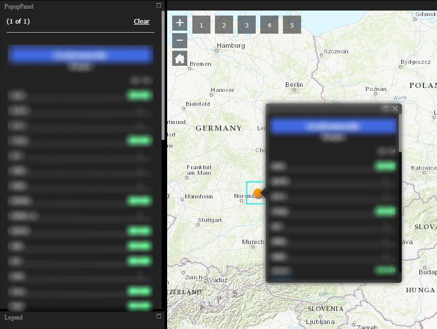

The problem I have now is, that when clicking on a feature in the map the PopUp opens in the side panel but also on the map.
Double Pop Up in map
How can I deactivate the in-map PopUp? Do I have to edit the JavaScript code, if so where do I find that file?

What theme are you using there and have you configured the Popup Panel widget to be opened at startup?
ManuelSchneider1
Interesting, your question made me try it in another theme, and it works there.
Before I used the Dashboard Theme where the duplicate Pop Up appears. I now switched to Jewelry Box Theme and the Pop Up now just shows up in the side Panel, not in the map as I wanted it to be.
So the widget does not work properly in the Dashboard Theme which is bad since I need its flexibility to show more data in multiple frames.
