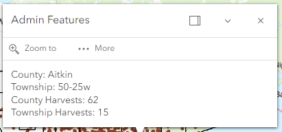

I have several Actions buttons in a popup. They are being pushed into a ...More button with a dropdown:
I don't want a ...More button. I would like all buttons to display without an additional click needed. It would be best if the buttons were stacked vertically in the calcite-action-bar element.

Interesting. I checked this today, and each individual button is showing now rather than going to a More... expansion panel. I am on a new machine, but that doesn't seem the culprit. I am using themes from js.arcgis.com (4.28), maybe the change was made there?
Jeff-Reinhart
Never mind on that last comment - whether the More... button or all buttons shows seems to be dependent on screen size and click location. Request still stands to have more control on how these buttons are presented.
