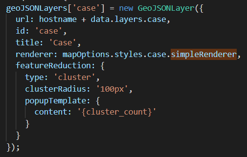

Hi. Im working with 4.14 version of JavaScript API. I would like to cluster my points but apparently, featureReduction cluster type is not working with my GeoJSONLayer instance. Am I not doing it correctly?
This is my code.

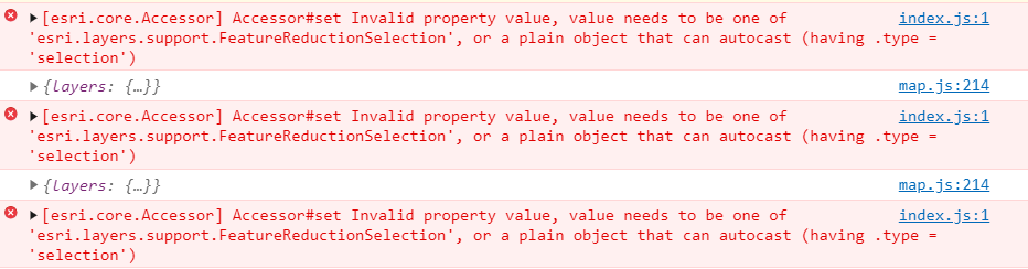

Getting this error.

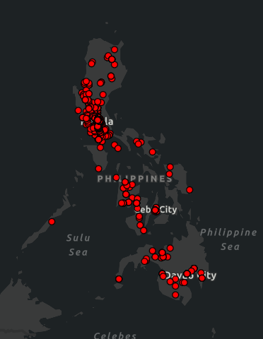

This is the map.

See that the point clustering was just implemented at the 4.14 release. Since I'm working with react, the esri-loader version I have can't load the 4.14 API, thus, defaulting to 4.13 version. I updated my esri-loader in this case by doing npm install --save esri-loader. Works now correctly.
