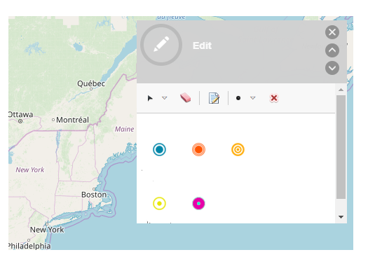

Denis,
  Here is what I was talking about:

8 Replies
RobertScheitlin__GISP
MVP Emeritus
Denis,
   It does not make any sense to me for you to try and use a dialog widget to hold the editor and template picker, since a Dialog dijit is Modal it will not allow you to interact with the map while it is open, thus defeating the intended purpose of the editor widget and template widget.
Den-GIS
Robert,
many thanks for your response!!!
I do not understand it. See screenshot: dojo dialog in "basic viewer" template (https://github.com/Esri/Viewer). Template picker and edit widget in dojo dialog. Is not it like that. Or I'm wrong?
MVP Emeritus
Denis,
   No that is not a Dojo Dijit Dialog. A dialog is Modal meaning that it is the only thing that can receive user interaction. What you picture there does not place an overlay over the rest of the app (to prevent user interaction) like the dialog dijit does.
Den-GIS
OK . I did not know it. I tried to integrate for 2 days. pointless! .
in any case, thank's !
MVP Emeritus
You should consider a FloatingPane dijit.
Den-GIS
I'll try it. give the feedback.
MVP Emeritus
Denis,

Den-GIS
great, you are fast!
That's what I was looking for
many many thanks
