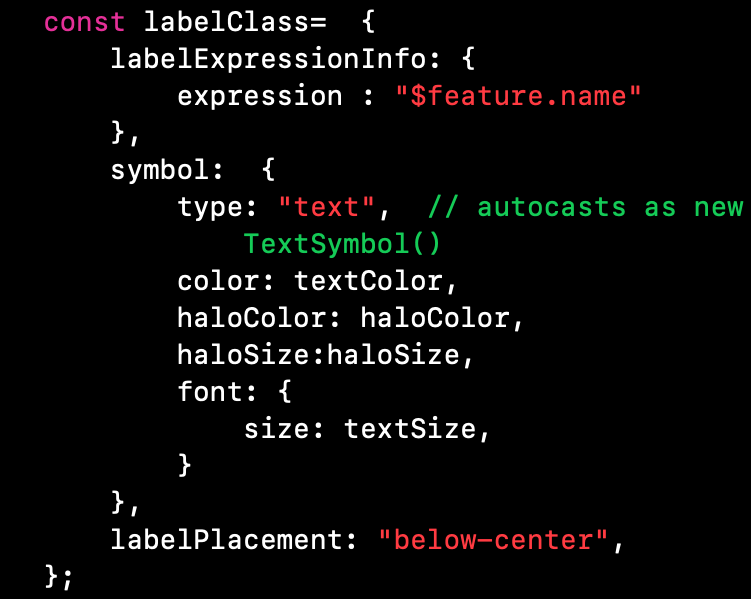

There is a labelingInfo like this
and I used it to my featureLayer which has about 40 features(each feature has a picture and a label). when the map first loaded,it will cost me about 30 seconds even minutes until the pictures and labels come out, while if I take the lables away, the loading will just take me about 5 senconds even less.However, the labels are very important and I can't take them away,what should I do to  reduce the loading time.

  Is there a particular need to label on the client? Why map label in ArcMap and use MapImageLayer instead. Labeling on the server is way better and faster.

At the earliest,we draw the picture and label on the sever,but we found that it looks better to draw them on the client. And now base on our business we should do it this way.  we tried to just use a label and a picture instead, but when the label are to long,and labes are closed to each other, some labels will be covered, and we found that the featureLayer can solve this problem,however, the features will come out after 30 seconds even longer.
