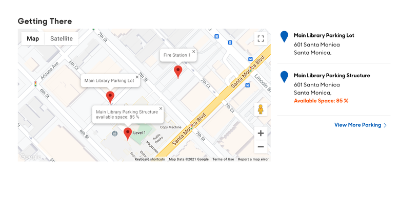

I'm trying to have multiple pop ups open like this -
just to confirm, you're saying no more than one info window can be open at a time, even if theyre really simple?
ReneRubalcava
Esri Frequent Contributor
That's right, only one popup at a time. It's a popup on the map, not per feature.
