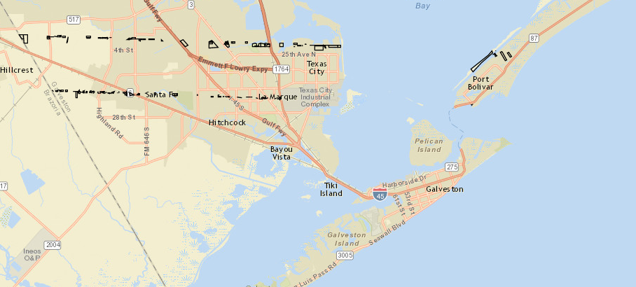

I'm pretty new to this, and I've been trying to follow the guides here. We have a simple service serving out a feature layer for parcels. When I load it up in in the ArcGIS.com map (the layer takes a minute to load), it displays fine. When I try to place it on a map in my own webpage, only a small number of the parcels display. Any help would be greatly appreciated. Below is my code:

Here's a screenshot of the map I get:

David,
   Your map service has a max number of features that it returns this is likely the issue. the default for a map service is 1000 features. this can be adjusted in ArcGIS Server Manager when editing the map service properties.

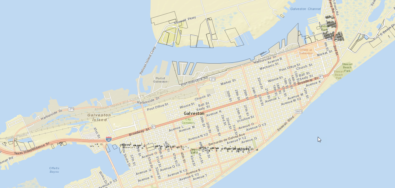

OK, we changed the MaxRecordCount to the number of parcels in our layer, and restricted it to a smaller area (just the island). However, we are still only seeing a small number of them:

David,
   I would look at your ArcGIS Server logs then as I tried your map service using the JS API 3.18 and got the same issue:

Oddly, the JS API v2.0 doesn't seem to have any problem with it. It seems to load the layer into an ArcGISDynamicMapServiceLayer, but I'm not sure how to translate that into the v4 API

Is there a way for me to get the number of polygons that are drawn on the map? I've been using the console to walk through the map and view objects, but can't seem to find anything.
Edit: Nevermind. Found it. Seems we're still being limited to 1000 features, even though we turned the setting up and restarted the map service. Is this a hard-set limit? Should I be following this guide?

David,
   I likely has something to do with your very old version of ArcGIS Server 10.01. I am not sure what to tell you tough besides give tech support a call.
