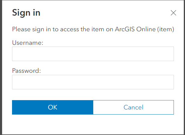

Trying to login to our company portal in ArcGIS Enterprise using (JavaScript 4.23), but the login takes me to ArcGIS Online. I provide the url in my JavaScript, but this still happens. Can you advise please. Thank you.
        var info = new OAuthInfo({
          appId:'oXxSEcZ4TXxuIl62',
          popup: false,
          portalUrl: 'https://test.cloud.esriuk.com'
        IdentityManager.registerOAuthInfos([info]);
