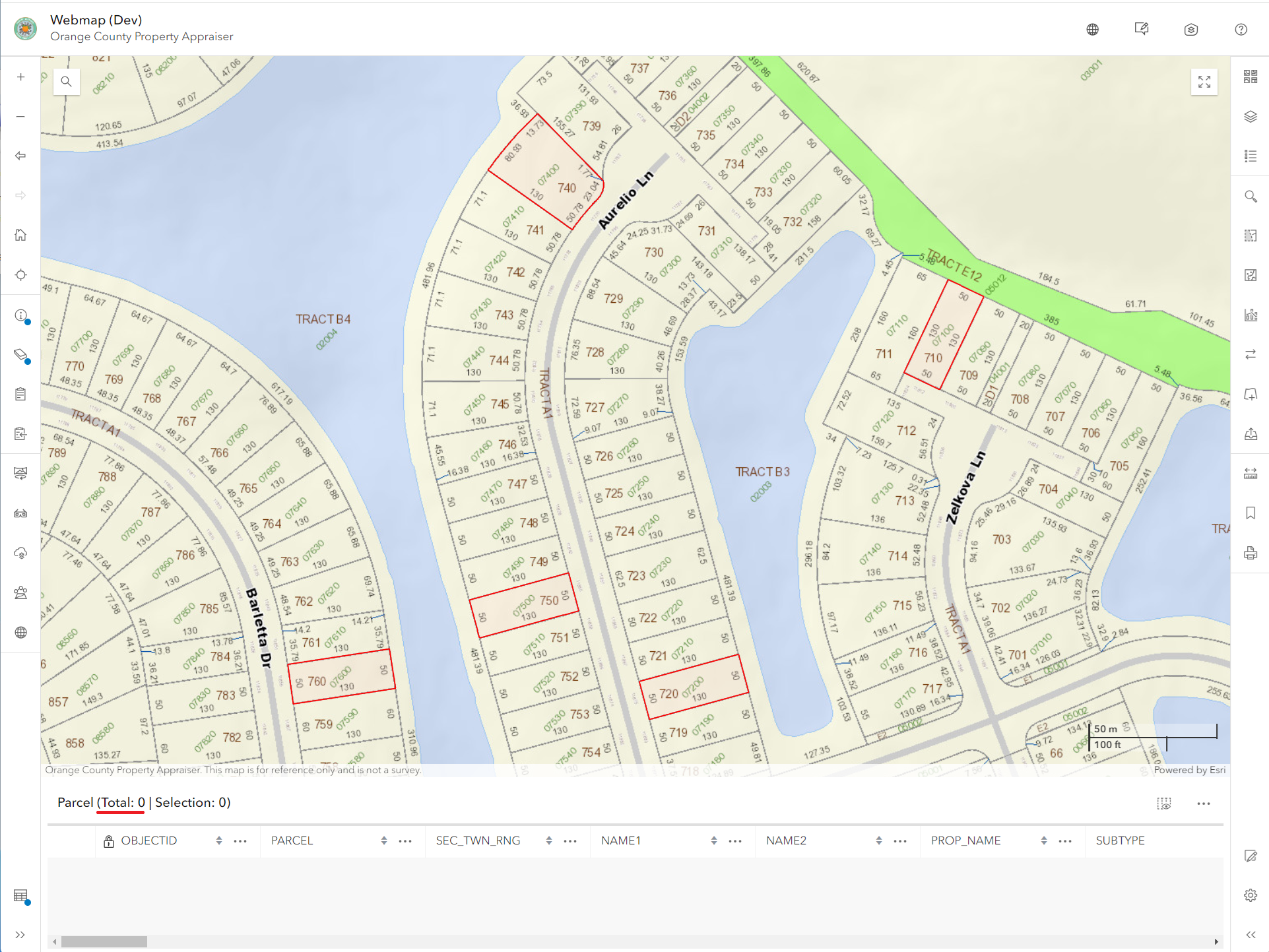

I'm trying to use FeatureTable with Client-Side FeatureLayer
1. Create Client-Side FeatureLayer with empty source:
      const featureLayer = new FeatureLayer({
                  source: [], //empty
                 geometryType: 'polygon',
                 objectIdField: "OBJECTID",
                 spatialReference,
                 editingEnabled: true,
2. Add it to map layer:
        view.map.add(featureLayer);
3. Create FeatureTable with featureTable
       const featureTable = new FeatureTable({
              layer: featureLayer,
               view,
               container,
               returnGeometryEnabled: true,
4. Add features to featureLayer using applyEdits
         const edits = {
              addFeatures: graphics  // will add 5 graphics
         featureLayer.applyEdits(edits)
            .then(editsResult => {
              console.log(editsResult.addFeatureResults.length);  // 5
              console.log(featureLayer.source.length);                     // 0
I got:
       editsResult.addFeatureResults.length = 5;
       featureLayer.source.length = 0;
The featureTable has no record, because featureLayer.source is still [] (empty).
