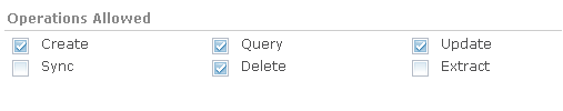

Hello,
Please check your feature service
to active delete in feature services required to marked as active...
ShaikhRizuan
Yes it is there...
