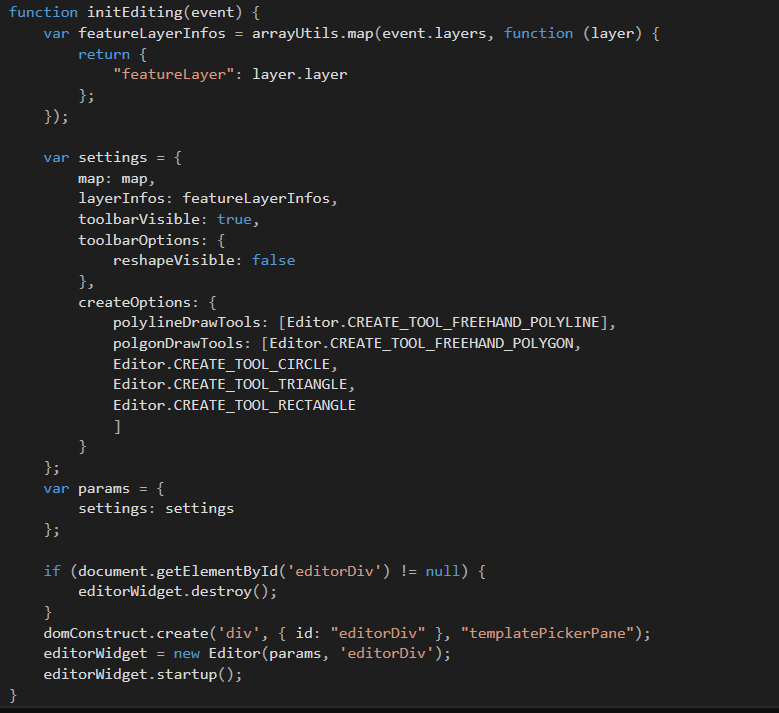

  • Debugged the code and found that it is valid code

Code:

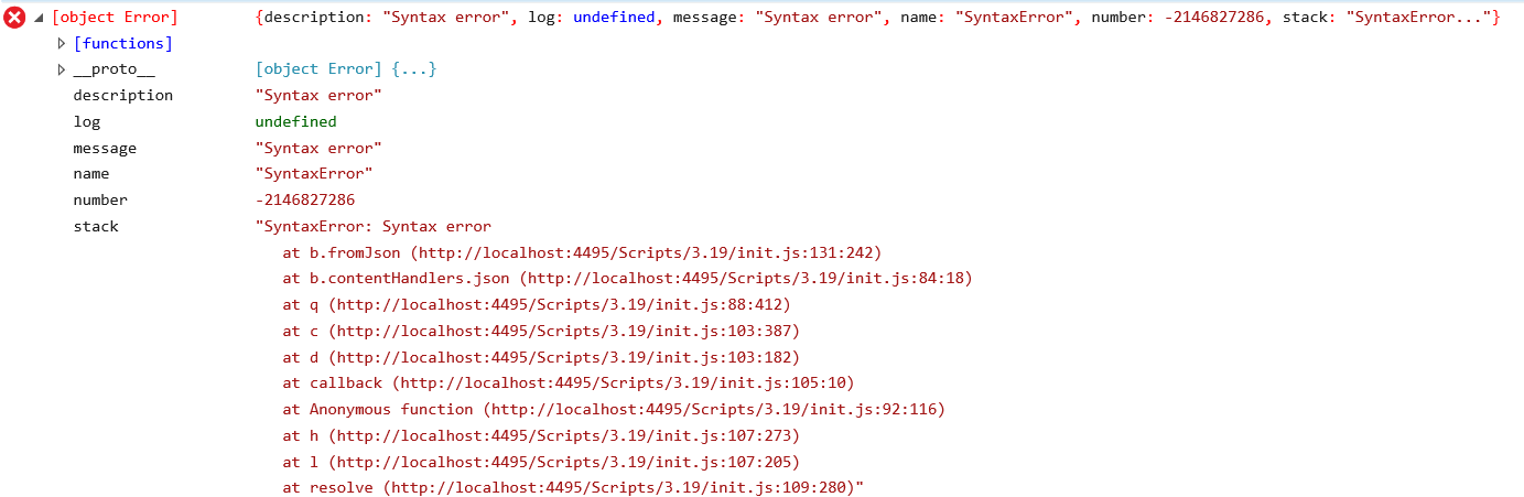

Error:

After thorough investigation I decided to check the POC which we showcased to the users earlier and found that it too fails to save the edits in feature layer.  So I decided to look on the windows patch level updates.  The recent patch which got installed was Windows Patch (KB4512517) on Aug19.  Hence, I selected a different server without this patch and tried publishing my feature service in that server and consumed in my web application.  Surprisingly, in my first attempt the edit operation successfully completed without any error !!!
I am still unclear whether this windows latest patch is causing the issue.  Hence, I decided to enable all server level logs in my ArcGIS Manager and didn't get any logs apart from the INFO request.
