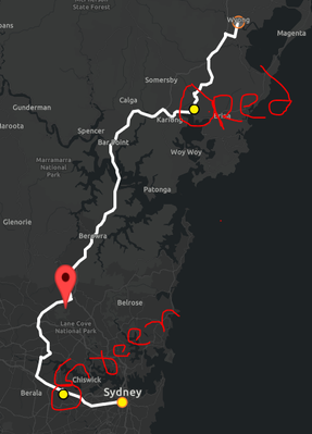

Hi,
Need to show different colors(4 diff colors) along with text to stops based on time delay. but facing challenges to give different colors to middle object.
currently I am using below sample code,

I need to show different color  for each stop based on condition. below the sample image
Noah-Sager
I see. I think we need a way to filter the waypoints based on the condition(s), and then overwrite the symbology for those points. I'll look into it to see if we can support this workflow.
