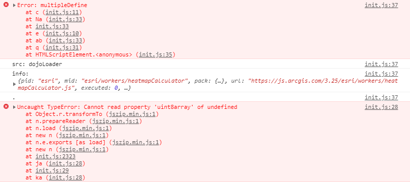

When i run the tool sometimes an error occurs and i get this message in the console:
This layer only participate in this process so i dont understand what can fail here. Any ideas?Ty.

It looks like you are using a js library called jszip? If so try loading it before you load the jsapi.
  <script src="https://cdnjs.cloudflare.com/ajax/libs/jszip/3.1.5/jszip.min.js"></script>
  <script src="https://js.arcgis.com/4.8"></script>

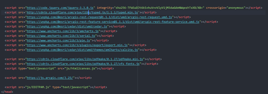

im not using that js library, my html looks like:
KellyHutchins
