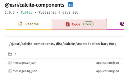

We have encountered an issue with a custom widget being used in Experience Builder where both the load and save functions fail to operate. We are using CDN-hosted calcite-components asset in our custom widget. After some investigation, it appears that the problem stems from using the CDN-hosted assets for esri calcite-components version 3.0.2. It has been working fine, but recently, the widget stopped functioning. We found that version 3.0.2 fails to locate message_ko.json.
The Korean language message file, which is required for proper localization, seems to be missing from the CDN version (v3.0.2) of the calcite-components assets. When the widget attempts to load this file, it encounters an error that prevents the widget from functioning correctly.

Can you verify that the versions of calcite being referenced are the same?
Calcite 3.0.2, the t9n files are named message.ko.json, not message_ko.json. The CDN asset may not be the same version used by ExB. I'm not familiar with the versions being used, but sounds like the issue.
