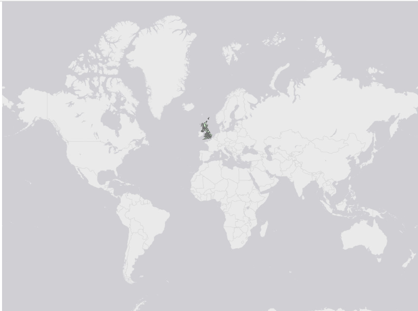

Greetings,
I am using the ESRI JS API 4.2
I am trying to use BNG grid coordinates for the Min/Max extent, and centre.
The map defaults to the world view, not UK extent?? I cannot see why it is not working??

I am using BNG (27700), not WGS84. So I don't see why the centre, extent and zoom is not honoured?? I would appreciate any pointers.

You can set the spatialReference on the MapView https://developers.arcgis.com/javascript/latest/api-reference/esri-views-MapView.html#spatialReferen... but your basemap also needs to match. The default esri basemaps are all web mercator and can't be reprojected.
