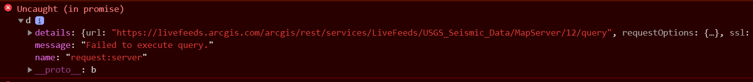

I have the following code to filter shake intensity maps by ID. It works fine with this URL -->  https://services9.arcgis.com/RHVPKKiFTONKtxq3/arcgis/rest/services/USGS_Seismic_Data_v1/FeatureServe...  but as soon as I plugin my production mapserver URL of --> https://livefeeds.arcgis.com/arcgis/rest/services/LiveFeeds/USGS_Seismic_Data/MapServer/12/  I immediately get a console error 400 query failing, i.e. below, and the map no longer displays.
error:

   Your definitionQuery is not using correct field names.
This would be the correct query text
layer.definitionExpression = "SeismicEvents.eventTime >= CURRENT_TIMESTAMP - 30 AND ShakeIntensity.grid_value > 2",

CamCode
Thank you for the response, Robert, however I don't think it's that. I have tried running it with that line commented out, and also just tried your change in any case and the console error still persists..
RobertScheitlin__GISP
MVP Emeritus
Cam,
   I did not spend the time to change all your field names in your code. Anywhere in your code you are specifying field names you need to ensure that you are using the correct field names for your final layer choice.
i.e id = SeismicEvents.id.
