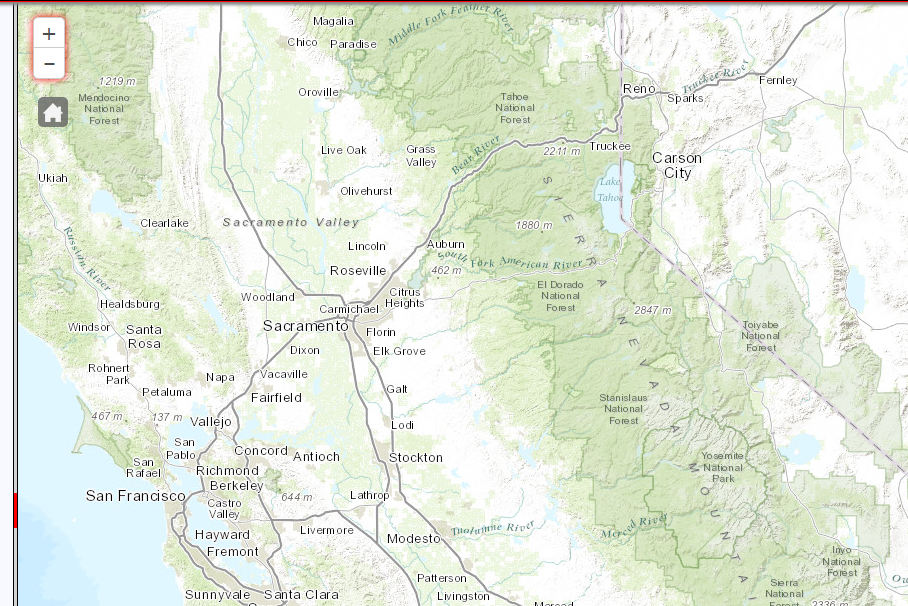

Hi all,
I am looking to add some show between the west and east panels (JQuery UI layout). I tried adding box-shadow: inset but dont get any positive results except in Firebug when I change the SVG map-gc.
End result should look like this:
As I have it, only the header box-shadow shows:

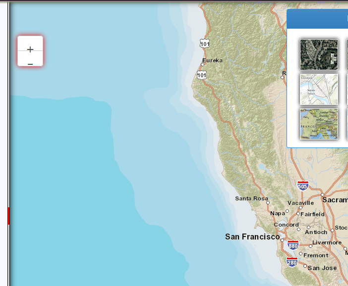

This is exactly what I am after. The only problem with this is that I am using JQuery UI Layout not dojo. the box-shadow: inset.... works great for this layout too but when I add the map to the center pane then the map it self hides the inset shadow. Playing around with Firefox, I saw that it could work if I add some css to "map.gc" SVG...
Now when adding some code "box-shadow: inset....!important" in my script, it does not do anything. Any idea?
