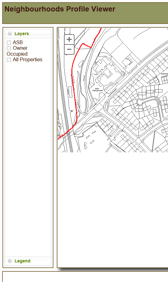

Hi,
I'm just getting to grips with the javascript api, and in particular the AMD coding style.
I have a simple page that I am rewriting in AMD style, everything works, but except the map only displays in half the available space. Doing anything to the browser e.g. zooming in (in the browser, not the map), or re sizing the window, causes the map element to display correctly filling the page. I believe this is due to the dom not being ready when the map loads, but is ready when the page is re sized.
I am using "dojo/domReady!" in my initial require[] statement, so I cant see why the dom isnt ready. However to complicate things, I tried including a "dojo/ready" function which should also monitor when the dom loads, this the function simply triggered an alert box message, but the function never fires:(
If any one has any suggestions how to resolve this, that would be great.
This page is being viewed in IE 11.

Martin,
  In your CSS try adding height and width to your mapDiv and remove the padding
#mapDiv {
  margin: 3px;
  border: solid 2px #79663b;
  height: inherit;
  width: inherit;
#mapDiv {
  margin: 3px;
  height: inherit;
  width: inherit;

Hi Robert,
That's fixed it, many thanks and much kudos your way!
I have to admit I don't quite understand why it has fixed it. I had partially rewritten the page from a previous one that was written in the legacy style. The old page using dojo.addOnLoad(init); style and the same css loaded with the map full screen?!
Thanks again,
Martin
RobertScheitlin__GISP
MVP Emeritus
Martin,
   It is all a timing issue really. Things happen in a different timing order in the legacy code.
