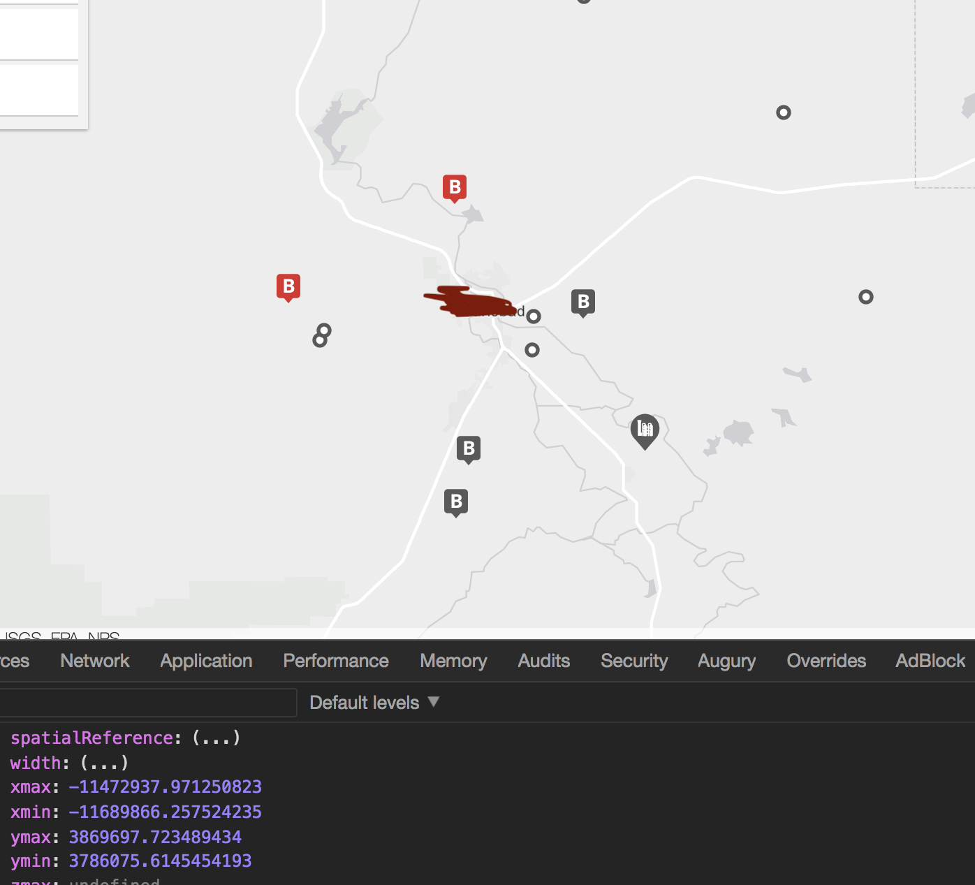

So in using the convexHull method, the extent that's returned simply contains xmin, xmax, ymin, ymax that are the respective min and max values from the geometries of my source data.   I had already derived the xmin, xmax, ymin, ymax values when I tried to manually instantiate the Extent object.  Perhaps I didn't instantiate the Extent with all the necessary parameters.  I'll keep looking.
So with this convexHull helper method, the same confusion exists.  The extent returned by it - I set it as the mapView.extent property.   However when I console.log out mapvView.extent, the xmax, ymin, ymax values are shown to be magnitudes greater than the extent values that was explicitly defined.  Perhaps this is due to the scale factor?
I was expecting the mapView's extent bounding to be essentially lat and long values.  However that doesn't seem to be the case.
Below shows the mapView extent's large x and y values.
