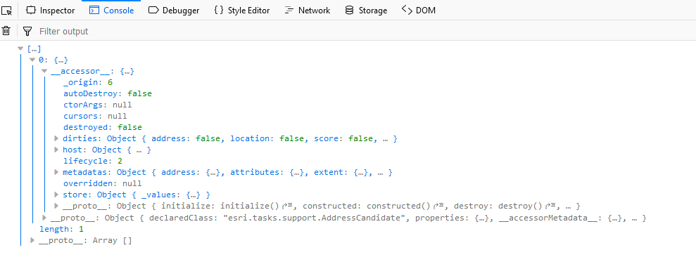

This is what I'm getting in the browser console:
Console
What I'm missing here? I should be getting Same URL used in browser address bar

That's odd. Perhaps I have accidentally turned off/on some feature in Firefox settings that is messing with the console output. I checked the same thing in Chrome console and it was showing the data as expected.
Not sure how I messed up Firefox though.

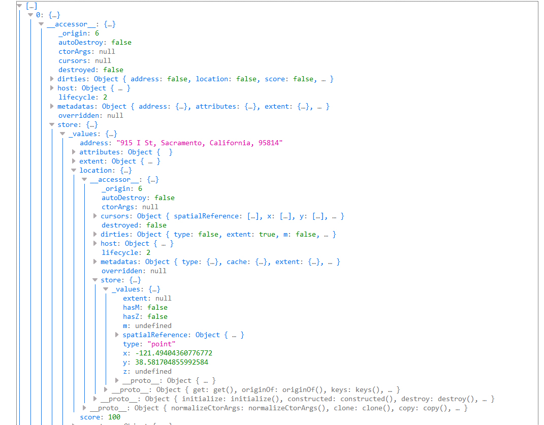

   The way that FF console report the object is different but the data is still there:
