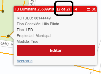

Ok, i make it work, but if i want to get the attributes from the infowindow when its more than 1 result?, like, lets say we have 2 results for the same point, but i only want to get the attributes from the second one .
Here is what i have in my code:
