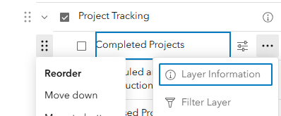

But then also: if we define a single button in the .actionSections, then that button is accessible as a cell (with arrow keys or tab). But if we define multiple actions, we get a list menu ("..."); visually, this menu-button remains a member of the focused row, but it is only accessible via 'tab' and not 'arrow keys'.
As a 'challenged user' new to all this, it feels like we're straddling two standards: if I need 'tab+Enter' to access the actionSection, then why can't I also use tab+Enter on the carat to expand the row?  Vis-versa, if I need to learn the treegrid pattern to expand a row, then why can't I also use arrow keys to navigate to the actionSection?
To exaggerate the issue: the .actionSection is fully navigable by arrow-keys once focus is on the "..." button, but then a left-arrow from anywhere in the .actionSection sends focus back to the TreeGrid and leaves the actionSection open (with an incorrect focus-highlight, too).
The reorder panel is similar, though it is focusable by arrow keys as a treegrid cell initially and you can expand the menu with either tab or down-arrow.  Once open, it has two different behaviors: tab moves focus to the next treegrid-cell and closes the reorder-menu, meanwhile, the right-arrow moves focus the same way but leaves the menu open (at least, unlike actionSection, it does remove the focus-highlight).
